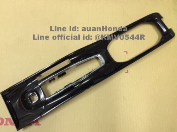

That's a very nice looking steering wheel.
Where do you guys get JDM part numbers? I've been looking for the part number for the JDM hybrid center console cover.
Actually I didn't know the part number until JDM Yamato got back to me after checking with Honda. I figured I'd share the info in case people had other means they wanted to use to try to source the part.
I've been looking for the 6-speed version of that center console too, but it's not a Japan part, since they don't have manual... prolly Euro or other Asian market unfortunately. After taking apart the console the other night, I think I'll just sand/spray that trim panel myself if it comes to that. Maybe carbon wrap or something.
I hadn't thought about that. I guess it can also be wrapped in gloss black to get that same look. It'll probably save me over $200 too. :)

Ya lol. It pops right off. I can't see spending the money on it anymore since you can paint/wrap it so easily haha.
