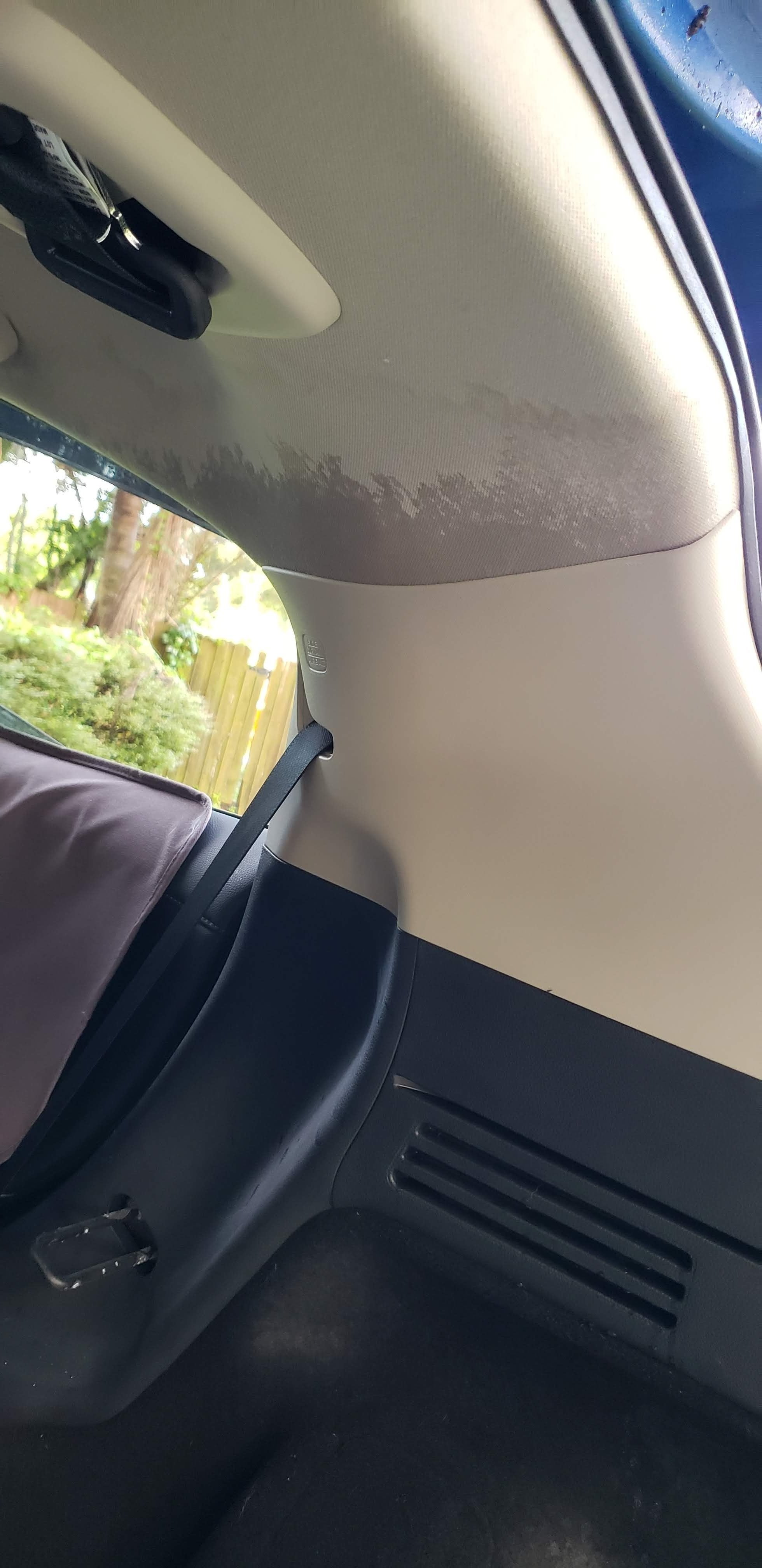

I have a 2018 HR-V EX-L. Leaking in the rear passenger compartment and hatch for the second time. The first time (Mar 2021) the dealership replaced the spoiler over the hatch door, damaged the roof in the process, fixed that and sent us on our way. I live in Florida, so it rains here quite a bit. Yesterday evening, we had a big storm and hubby found new leaking this morning. I've already been in touch with our local retailer where I bought the car, new, in June 2018. Of course, now I am out of warranty so I'm hoping the service contract I purchased will pick up the slack. Some of the other sites I've looked at are suggesting that this is caused by issues at the manufacturing level and the welds in the body not being correctly sealed. Any thoughts?
Crystal
#53 ·
Crystal
View attachment 34864 View attachment 34865 View attachment 34866
there are people on here that said they found some developed cracks under the roof rails - some sealer Honda uses cracks, and it allows water in here at the back of the car - roof level.
Search for that in these forums for pics etc.- and fixes for this.(If needed)
