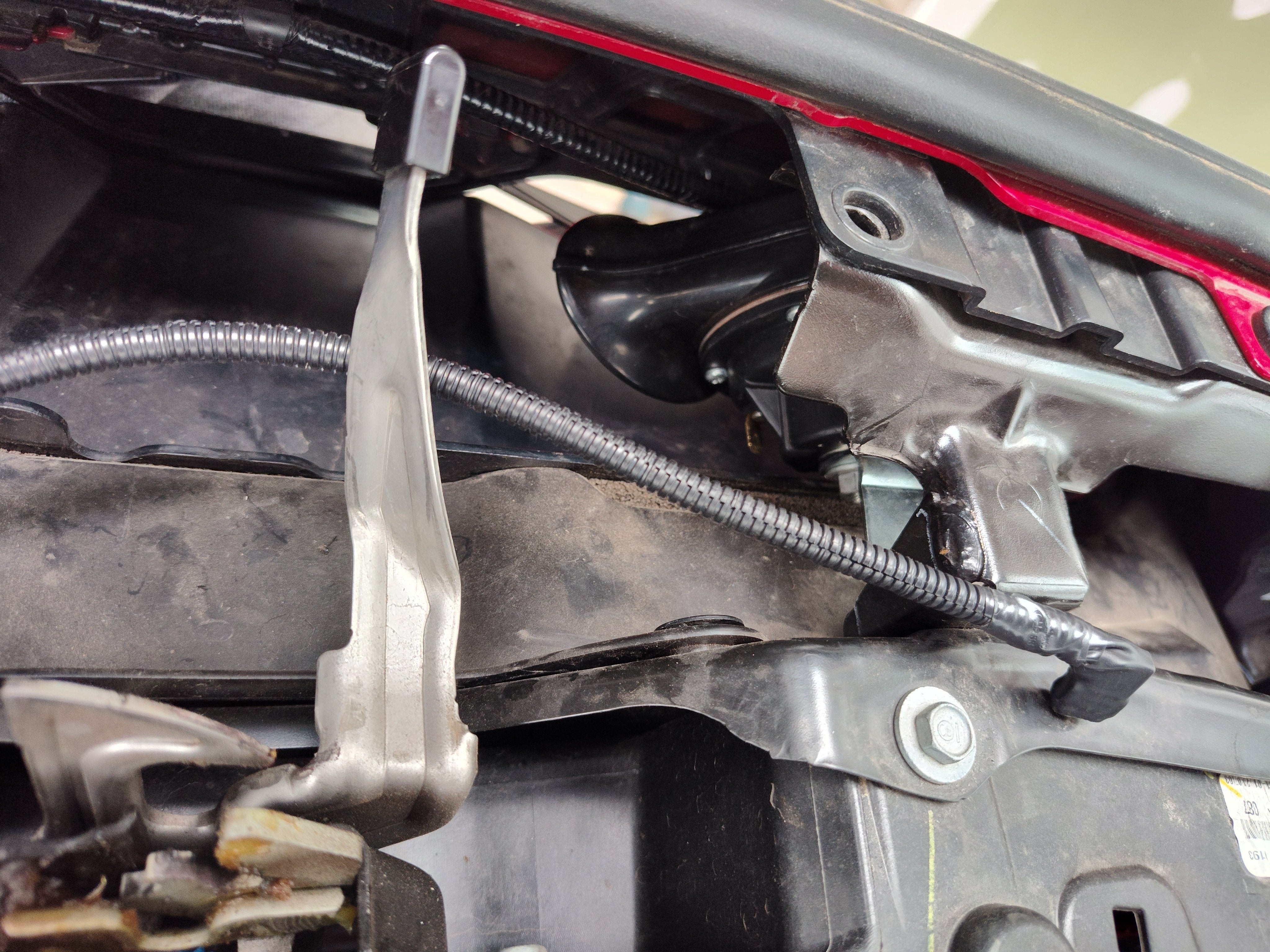

So, grab yourself a low tone snail style horn on Amazon. If you get a "chassis negative" horn it will make your life easier. Because it'll need only the positive wire, so one less wire to run.
Mount your low tone horn somewhere where it will be fastened to metal in the car's chassis. This will connect the horn to the negative pole of the battery using the chassis as a conductor. I found a place behind the grille towards the passenger side where there was a metal screw (it's mostly plastic fasteners in that area). It's easy to get to, just remove 5 plastic push pins and pull out the plastic trim surrounding the hood latch.
The horn came with a metal strip that I then bent on the bench vise in a shape that would hold the horn in the correct position.

After I verified it works I got some 3/16" corrugated electric hose/loom. 2ft will be enough. I got the type that is slit open so you can slide it over a wire that's already connected. I slid it over the wire and ran it under the plastic trim panel around the hood latch, then behind the driver's side headlight and down where a big-ish inline multi pin connector pair is. This is behind the driver side headlight and in front of the fuse box, but further down into the engine bay near the driver side "chassis rail".
