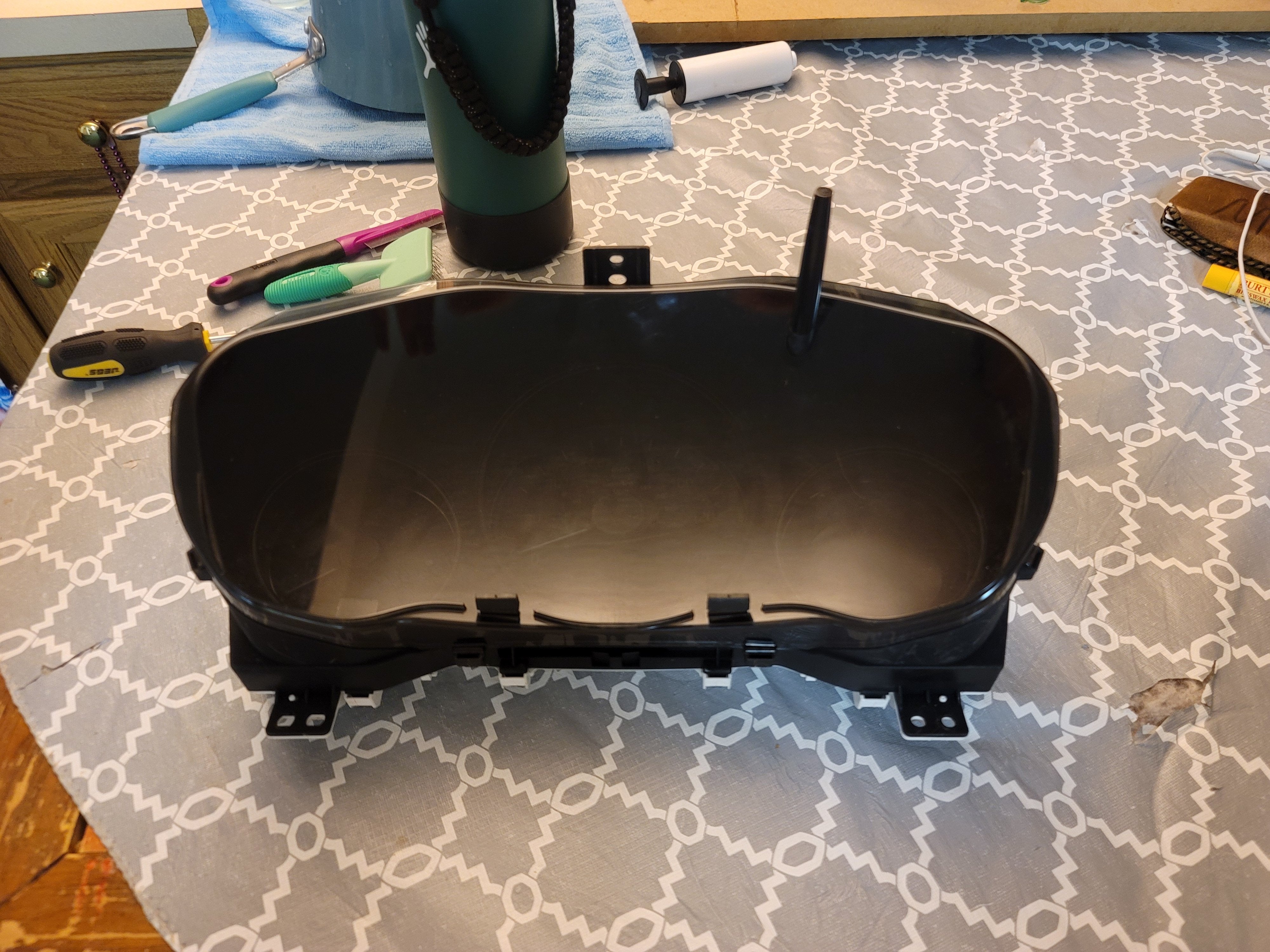

Alright so I took my odometer cluster all the way out of my car and disassembled it as far as I could. I saw a couple spit that were dirty and cleaned those. I ended up loosening all the screws and retightening them clean some other connection points with alcohol and cotton swabs and put it all back together and I have not had any issues as of right now. It has been really hot and it has also rained and has been humid. It was happening pretty regularly of me getting in the car and it was about 2 or 3 times a day it would get all digitized. As for now it is working great.

Alright so I took my odometer cluster all the way out of my car and disassembled it as far as I could. I saw a couple spit that were dirty and cleaned those. I ended up loosening all the screws and retightening them clean some other connection points with alcohol and cotton swabs and put it all back together and I have not had any issues as of right now. It has been really hot and it has also rained and has been humid. It was happening pretty regularly of me getting in the car and it was about 2 or 3 times a day it would get all digitized. As for now it is working great. View attachment 32167 View attachment 32168 View attachment 32169 View attachment 32170 View attachment 32172
Good job! Let us know if it ever comes back. I know someone else had posted that they asked the dealership about it and they suggest replacing the whole cluster which was big bucks (although everything is big bucks to me). You’re lucky that you have the knowledge, tools and ability to do these types of repairs yourself.
Nice work! And thanks much for the update and images. I don't have this problem... hopefully it doesn't develop. But if I do I'll have a starting point.
Oh yeah no problem! Honestly car places and dealerships make it sound way more difficult that it actually is. All it took was a Phillips screwdriver and four screws to take the whole cluster out and the plastic surrounding it just pops right off then the cluster only had a couple screws too and that was all. I guess in my case I'm out of a warranty period because of my title so I didn't mind trying to figure it out. But I will let you know if it comes back ever thanks!
