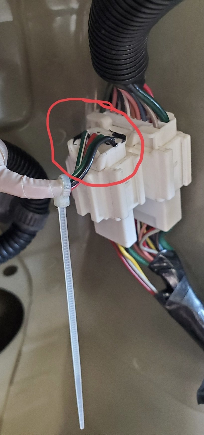

Found a possible solution. I was about to change the complete trunk harness when I discovered cables were bent at one of the connectors. Straightened the cables and the
trunk started unlatching without problems, bent the cables again and it would stop working. As a temporary solution, straightened the cables with electric tape and it has been working perfectly since.

Found a possible solution. I was about to change the complete trunk harness when I discovered cables were bent at one of the connectors. Straightened the cables and the View attachment 33079
2017 Honda HR-V LX
how did you reach those cables and where they are?
2017 Honda HR-V LX
I've tried to find that harness but nothing looks like that (2 connectors side by side) underneath the plastic cover. Can you show (pic or drawing) where that connectors are located?
